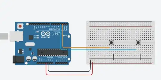

I made a little model i Tinkercad
Arduino with two push buttons
Whenever you push left button PIN2 of the Arduino gets shorted to ground. Whenever you push right button PIN3 of the Arduino gets shorted to ground.
And now my source code
void setup()
  pinMode(2, INPUT_PULLUP);
  pinMode(3, INPUT_PULLUP);
  interrupts();
  attachInterrupt(digitalPinToInterrupt(2), Player1ButtonPress, FALLING);
  attachInterrupt(digitalPinToInterrupt(3), Player2ButtonPress, FALLING);
  Serial.begin(9600);
void Player1ButtonPress() {
  Serial.println("Player 1 wins");
void Player2ButtonPress() {
  Serial.println("Player 2 wins");
void loop()
    //nothing here
And now some explanation. In setup we first setup PIN2 and PIN3 as "input with pullup resistor". In our design this means that when button is not pressed those pins will have 5V on them, but as soon as the buttons are pressed voltages go down to 0V. Then we make sure that interrupts are turned on (they are on by default, but I like to show everyone who is reading the code that I will be using them) and then we do some attachInterrupt magic. We make that a "falling edge" (change from 5V to 0V) on PIN2 and PIN3 will immediately run methods Player1ButtonPress and Player2ButtonPress.
When I was playing with buttons they worked perfectly.
