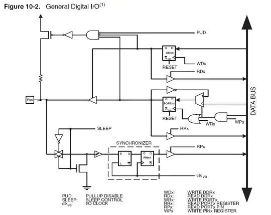

where in datasheet there is a warning about this gotcha?
In section 18.2.4 – Reading the Pin Value: “[The synchronizing latch] is needed to avoid metastability if the physical pin changes value near the edge of the internal clock, but it also introduces a delay.” (emphasis mine).
Edit: In a previous version of this answer, I incorrectly stated that sbi is a single cycle instruction, which required the voltage to rise in half a cycle instead of 1.5 cycles. The corrected timing is still short enough for stray capacitance to be a valid explanation of the observed behavior.
In summary:
  • The stray capacitance attached to the pin, together with the pullup resistor, for an RC circuit.
  • As the pin is initially floating, it's initial voltage is unpredictable.
  • When the pullup is turned on, the voltage starts to rise from whatever initial value it had to 5 V.
  • After some time, which can be typically of the order of the RC time constant, the input Schmitt trigger turns HIGH.
  • After some extra delay introduced by the synchronizer, the PINxn flip-flop turns HIGH.
  • If the CPU reads the PINx register before that happens, it gets a LOW reading.

-1
This actually is documented in the datasheet and illustrated by the logic diagram of the typical GPIO, to see what is really going on behind your compiled code you need to look at the generated assembly code and which registers are being accessed:
When you change one bit of an IO port, you are either modifying the 8 bit register on which that bit is mapped using the WRx signal or just the 1 bit register for the pin alone using the WPx signal. When you use the WPx signal to set or clear the bit, you don't need to know the states of the other pins so the discussion ends here. However, when you use the WRx signal to MODIFY a single bit, you need to know the states of the other 7 bits which means that your need to read the 8 bit port. You can either read the port LATCH using the RRx signal or you can read the actual physical pins using the RPx signal. Now when using the RRx signal, no amount of loading or noise on the pins themselves will affect what is read from the output of the port latch but when using the RPx signal, if a previous write to the port is followed by a read of the port, any parasitics or noise on the OUTPUT pins may cause a pin that you think that you just set to a one suddenly becomes a zero.
The reason this happens is because of how opcodes are pipelined. Writes to ports happen at the end of the last instruction clock but reads happen at the beginning so that there is essentially zero time between when you set that bit to a 1 and when you change some other bit (Read-modify-write fashion) so that bit is still a zero when it is read and then immediately written as a zero.
As illustrated below, this can be rectified by inserting a delay between write and read-modify-write opcodes to let the pin states stabilize. The delay must take into account the capacitive loading and noise environment

  • The WRx vs WPx distinction has nothing to do with whether you are writing a single bit or the whole register: WRx is the signal for writing the PORTxn flip-flop, whereas WPx is for writing PINxn (which is actually used to toggle PORTxn). And note that the OP did include a two-cycle delay between writing and reading. – Edgar Bonet Aug 10 '18 at 08:17
  • You have apparently missed the entire point: When read-modify-write reads from the pins and then writes the latch, noise or delay on outputs can be re-written to the output and possibly changing the output's state unintentionally. Adding one cycle, tow cycles or a thousand cycles of delay may not be sufficient and understanding the mechanism of this uncertainty is the only way to build robust platforms that operate predictably under ALL circumstances. – John Taylor Aug 11 '18 at 18:07
  • You also missed my point. I told you about a factual error in your answer. The appropriate response in this case is to edit the answer and fix the error. Your point that I still don't get is the one about “When read-modify-write reads from the pins and then writes the latch [...]”. Do you actually mean “reads from PINx and writes to PORTx”? If so, it's irrelevant. Nobody does that. Certainly not the OP. – Edgar Bonet Aug 11 '18 at 19:33
