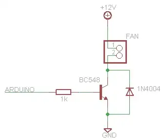

You are correct in your assumption that you can not power a fan from an Arduino directly.
Use a transistor, for example 2N2222 or BC548, which is switched by the Arduino, using a single pin, in order to provide sufficient current to the fan.
Such as this simple circuit (note that the 12V supply would be 5V in your case):
Transistor powering a fan
Source: Driving a PC fan - transistor with or without an optocoupler?1
However, as chrisl has pointed out, you fan has three pins and not two. The above circuit will only work for a two pin fan. In your case, for the reasons stated in Chrisl's answer, one pin goes to 5 V supply, one to GND and then third goes directly to the Arduino - let's say pin 3. Then you can use the code below.

  • The OP has a 3 pin fan for 5V, not 12V. The third pin is already connected internally to a driver (propably a MOSFET), which can be driven with PWM. So the extra MOSFET is not needed here. – chrisl Jun 29 '18 at 21:43
  • @chrisl - ah yes, you are quite right. I read the question in too much of a hurry. Your answer is more correct. I shall modify mine to make note that the voltage is 5 and not 12V. Thanks – Greenonline Jun 29 '18 at 21:47
