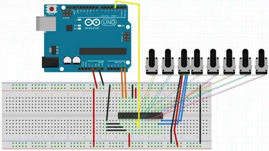

Library and schematics are at https://github.com/maxgerhardt/rotary-encoder-over-mcp23017.

For 1 encoder, one can write down schematic like: (interrupt based)
schem
Since one MCP23017 has 16 ports, we can connect up to 8 rotary encoders to one such device.
However the MCP23017 also has three address pins with which its I2C address can be selected. This means we can have 2^3 = 8 such device on the same I2C bus (i.e., connected to the same SDA and SCL lines).
Thus, with one I2C bus, which uses 2 pins, we can have a maximum of 8xMCP23017 and 64 rotary encoders (assuming no interrupts are used, which would need 1 pin for any number of rotary encoders). At the cost of 2 more pins on the microcontroller, we can create another software bit-banged I2C bus, each of which adds again a maximum of 64 rotary encoders.
Assuming D2 to D13 and A0 to A5 are free, on these 18 pins we can have 9 I2C buses with a total of 72 MCP23017 devices hosting a grand total of 576 rotary encoders. Whatever one might need that for.
I've tested this library with one rotary encoder and a MCP23017, but the code is structured in a way that adding more encoders is just adding an entry in an array.
