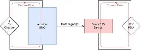

Let’s take a look at the typical circuit from the original question. An Arduino connected to some 12V device (such as some 12V LEDs):
Here you can see the Arduino connected to, for example, a 5V USB charger. It could be a battery, or it could be the USB port on your computer. It doesn't matter. Connected to that is a 12V device which then has its own 12V power supply. Now. Where is ground in that circuit?
The 5V pin of the Arduino is 5V with respect to the ground pin of the Arduino. So seen from the Arduino’s point of view ground is, in the image above, the bottom line of the Arduino’s power circuit (charger -). However, the 12V of the external circuit is 12V with respect to the – side of the 12V PSU. So seen from the point of view of the 12V device the ground is the lower side of the 12V circuit – the “PSU -” connection.
That doesn’t sound too bad, does it? Each device’s power is correct with respect to the power supply it is running off. As far as that goes, sure. However take a look at the data signal going from the Arduino to the 12V device. What voltage is that at?
Well, seen from the Arduino’s point of view, with respect to its ground, since it is generating the signal, it is a 5V signal. But, what about what the 12V device sees? What voltage is that signal with respect to the 12V circuit ground?
Given that voltages aren’t absolute – they are only relative to a reference point within the same circuit, it is impossible to know what the voltage is there.
There’s something more fundamental at play here though which can help you to understand it even better. In the image above there are two red arrows in loops. That is the flow of the current around the circuit (shown as conventional current flow). The key phrase there is around the circuit. Current has to flow out of a supply, through a circuit, and back to the supply from where it came.
In the circuit above the current can flow out of the 5V, through the Arduino, and back to the 5V again because there is a complete loop there. Likewise there is a loop from the 12V supply, through the 12V device, and back to the 12V supply again. But there is no such loop for the signal from the Arduino to the 12V device. If we think of the Arduino’s output pin as a small power supply there really should be some way for the current to get out of the Arduino, through whatever it is connected to, and then back to the Arduino again. There is no way for that to happen in this circuit.
