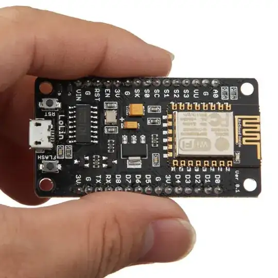

I have this LoLin NodeMcu V3 board:
LoLin NodeMcu V3
What are the pins S3, S2, S1, SC, S0, SK? Can I use them as GPIO in Arduino?

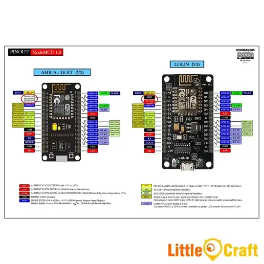

This picture found here explains the pins: lolinv3
