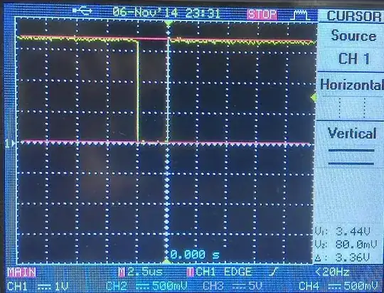

Now when SPI.transfer(10,1) is called in loop(), I always see that the slave selected pin goes down to 1.65V, but not 0 as it should! (see image below)
pin mode set before calling SPI functions

We get what we would expect when calling SPI.transfer:
pin Mode not set
Is that a bug or do you have an explanation for that behaviour?
