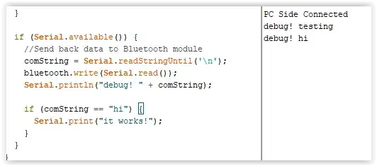

I am wondering what is wrong with my code below. I have 2 issues.
The first issue, I am checking if c equals "hi" and if it does then display said hi. I currently see the output of c when it hits Serial.println(c); but never see the said hi even though Serial.println(c); does say "said hi".
The second issue is that when I start up the Arduino I am sending the AT command using bluetooth.println("AT");, but all it seems to do is display AT on the phone instead of OK as it should.
This is not how you compare:
  if (c.equals('hi')) {
Single quotes indicate a single (or multi-byte) character. A character string (lower-case) is enclosed by double quotes:
  if (c == "hi") {
But it's better to avoid the String class (more info here).
To eliminate the String class, use char arrays instead (aka "C strings") and accumulate characters until the newline is received. There are many, many C string functions for manipulating and searching. In this specific case, you would use strcmp or strstr for comparison:
