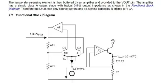

The cause is the low sinking capabilities of LM35 output. This makes the output sensitive to EMI. Yes, the output output impedance is stated as 0.5 ohms but only for sourcing current. The sinking current is limited to 1uA which is easily achieved by the environment noise. enter image description here
You need to add a low impedance load between LM35 output and ground, can be 200 ohm as the data sheet recommends for heavy capacitive loads but I wouldn't go that far, might be 1k or 2k to avoid self heating errors.
No software only solution can solve this error.

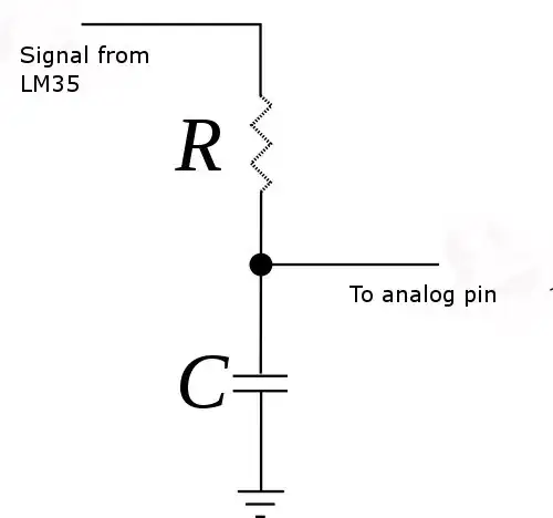

If issue with readings persist, put an RC circuit for measuring the voltage as it is similar to averaging done in software. Another thing that you can try is replacing the LM35 with a new one as sometimes it could be faulty or you might have damaged it(has happened with me). However u can easily check this by measuring the voltage at the sensing pin whether it corresponds to what you are getting. If you are working with electronics please invest in a multi-meter as it will help you in all your projects
