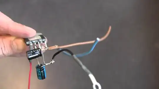

Point-to-Point
Just solder directly component to component. You can arrange your component for minimal space and minimal wiring length. Can be very elegant (depends on your abilities) and doesn't require any board.
Point to point example

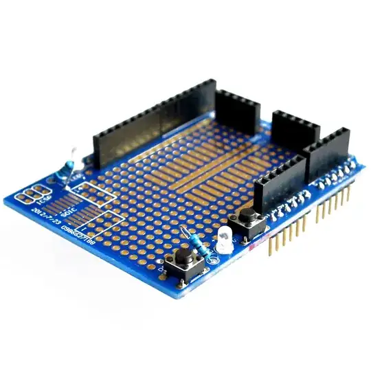

To make it easy, you can buy so-called proto shields for Arduino like below.
The advantage is that you can stick it directly on your Arduino (Uno/Mega) and you can soldier the extra components on the proto space.
Proto shield

  • and the connection will be same as that on the breakboard? or will I have to make some changes? like i said I am new to all this. Sorry if my question sounds stupid – Saad Bashir Aug 18 '17 at 10:28
  • It's not a stupid questions ... when I started half year ago I had the same problems. Btw, I never used a proto board like this. But yes, they have the same connections. (I used normal shields, meaning shields which you can stick on top of an Arduino Uno or Mega with premade components, e.g. for SD cards). But with a proto shield you can add your own components. – Michel Keijzers Aug 18 '17 at 10:30
  • I basically want to connect four sensors. And I am unable to figure out how to do it without the breakboard. I want to connect humidity sensor, relay board 5v, pir sensor, and solenoid valve. Do you think there is a shield available for something like this? – Saad Bashir Aug 18 '17 at 10:34
  • I know there are boards with preassembled sensors, but I doubt it's exactly the ones you need. Btw, you can normally stack multiple boards on top of each other, but I doubt you will find exactly the configuration you want. In that case, I would use a proto shield (if they can fit on one proto shield). – Michel Keijzers Aug 18 '17 at 10:37

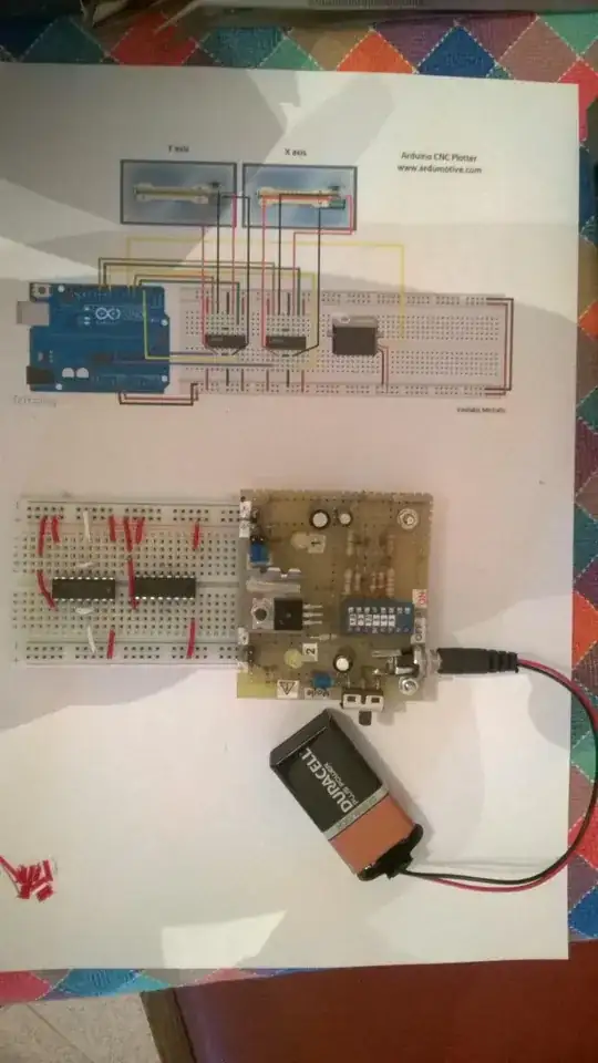

I have not had much luck with breadboards either. I see, on internet, that others seem to make even quite complex circuits. I can only assume it means I need to take more care to insert the components better and perhaps spend a bit more on a better quality product? I see the replies all give alternatives but no suggestions as to why Saad has problems and how to improve I would be interested to know too! At the moment, I also solder components to breadboards but it is a pain if I have to de-solder. I also use one of those childrens kits for experimenting with electronics together with a solderless bread board. It has transistors and capacitors etc and so I can connect it to IC or other particular components fitted to the [![enter image description here][1]][1]solderless breadboard. The photo is just to give an idea. I have also tried soldering small female sockets to breadboards and plug the various components into those for testing.
I have been experimenting more and reading some articles on internet. In fact, I found it better to make small jumper wires, rather than use tje ready made ones. The ready made ones tend to move and the contact is not so secure. It is nit so easy to make the small jumpers though and needs patience! I also made a small switch power supply board.. I found on "instructables" https://www.instructables.com/id/Ultimate-DIY-Breadboard-Power-Supply/#CB1TV2QJ70QKF7I It plugs into the bread board and I can select a required voltage
[1]: https://i.stack.imgur.com/sXOmY.jpgenter image description hereenter image description here
