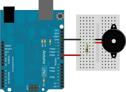

Fortunately for you, Arduino already has a pieze-electric buzzer library, and wiring it up is dead simple. The relevant GPIO pin is connected to the buzzer's positive terminal, and the buzzers negative terminal is grounded.
Wiring of Arduino Uno to Pieze Electric Buzzer
Cloud
  • 111
  • Great, so then in this particular example, the piezo is being powered by the connection to digital pin 8 correct? And we could reliably assume that circuit current is definitely less than 40 mA and probably lower than 20 mA before we measure it? Also, technically speaking, could we say that electrons are in fact flowing from the board's GND to digital pin 8? – Jog Sep 27 '14 at 14:58
  • @Jog I don't know how a piezo-electric buzzer alters current flow, so let's just assume it's limited to Vcc / R at the most. Forget about the flow of electrons, just accept that the "conventional current" is flowing from the output of GPIO pin 8, through the resistor and buzzer, into the ground, as part of a closed circuit. If you need more current than the Arduino can supply, just have the Arduino connects to the gate of a power MOSFET (ie: http://www.hobbytronics.co.uk/image/data/tutorial/arduino-tutorial/power_mosfet.jpg). – Cloud Sep 28 '14 at 02:13
