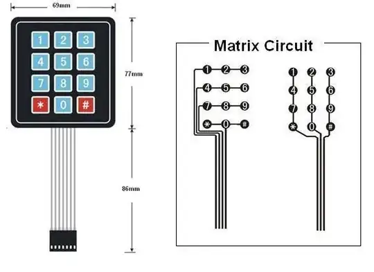

Firstly, I would recommend a matrix keypad instead of the DTMF keypad as it is much easier to use with an Arduino. This will also allow you to use a multiplexer which would use fewer pins.
Keypad and matrix circuit
