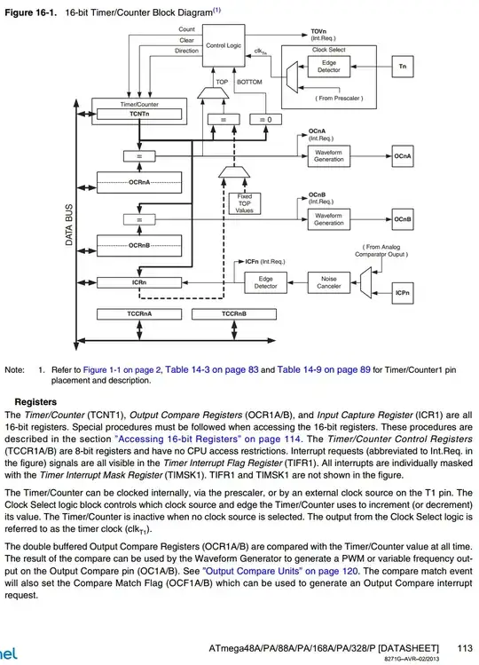

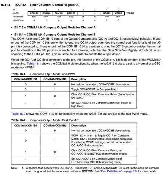

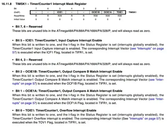

enter image description here enter image description here enter image description here
So, for example, TIMSK1 |= (1 << TOIE1); sets the bit TOIE1 in TIMSK1. This is achieved by shifting binary 1 (0b00000001) to the left by TOIE1 bits, with TOIE1 being defined in a header file as 0. This is then bitwise ORed into the current value of TIMSK1, which effectively set this one bit high.
Looking at the documentation for bit 0 of TIMSK1, we can see it is described as
When this bit is written to one, and the I-flag in the Status Register is set (interrupts globally enabled), the Timer/Counter1 Overflow interrupt is enabled. The corresponding Interrupt Vector (See ”Interrupts” on page 57) is executed when the TOV1 Flag, located in TIFR1, is set.
All the other lines should be interpreted in the same manner.

TCCR1A is timer/counter 1 control register A
TCCR1B is timer/counter 1 control register B
TCNT1 is timer/counter 1's counter value
CS12 is the 3rd clock select bit for timer/counter 1
TIMSK1 is timer/counter 1's interrupt mask register
TOIE1 is the timer/counter 1 overflow interrupt enable
So, the code enables timer/counter 1 at 62.5 kHz and sets the value to 34286. Then it enable the overflow interrupt so when it reaches 65535, it will trigger the interrupt function, most likely labelled as ISR(timer0_overflow_vect)

CS12 has a value of 2 since it represents bit 2 of the TCCR1B register.
(1 << CS12) takes the value 1 (0b00000001) and shifts it left 2 times to get (0b00000100). The order of operations dictates that things in () happen first, so this is done before the "|=" is evaluated.
(1 << CS10) takes the value 1 (0b00000001) and shifts it left 0 times to get (0b00000001). The order of operations dictates that things in () happen first, so this is done before the "|=" is evaluated.
So now we get TCCR1B |= 0b00000101, which is the same as TCCR1B = TCCR1B | 0b00000101.
Since "|" is "OR", all the bits other than CS12 in TCCR1B are unaffected.
