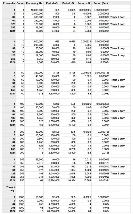

I have a discussion about timers on http://www.gammon.com.au/timers.
On that page is a chart which helps visualize the effects of different prescalers:
Timers and prescalers
The top part (count of one) effectively gives you the granularity of each prescaler. For example, a prescaler of 256 has a granularity of 16,000 ns (16 µs). Certain frequencies (powers of 2) will lend themselves to combinations (eg. prescaler of 1 with a count of 256, or prescaler of 256 with a count of 1).
However for frequencies that don't have that property, the smaller prescaler will (if it can be used) give a finer granularity.

  • Using a higher prescaler does not loose any precision at all. You do get bigger granularity, but if you target a cycle count that is a power of two (like in the question), granularity is not an issue. – Edgar Bonet Jan 14 '16 at 10:50
  • But if not, then the lower prescaler lets you get closer to the target. Say you want to time 30 clock cycles. A prescaler of 1 lets you enter the number 30 directly. A prescaler of 8 means you have to use 30 / 8 (3.75) which you cannot directly enter into the register, thus losing precision. – Nick Gammon Jan 14 '16 at 20:55
  • The question was worded with 1024 counts, so my remarks don't apply to that, but I was trying to give a more general answer, in case the fact that 1024 is a rather special case wasn't obvious. – Nick Gammon Jan 14 '16 at 20:56
