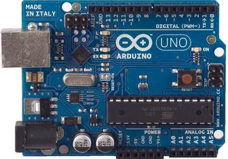

Hi I am trying to make Arduino Uno on local network with the help of ESP8266 wifi module.
I tried to search on internet, found mostly they are making ESP8266 as web server.http://circuits4you.com/2016/12/16/esp8266-web-server-html/
Can anyone help me how to add Arduino Uno on network with the help of ESP8266. enter image description here
