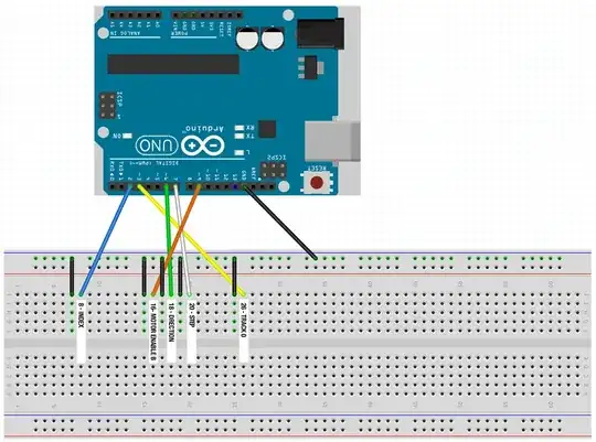

I am having problems controlling a 3.5" Floppy Disk Drive with an Arduino Uno.
I have the floppy disk drive powered with a computer power supply that is switched on, and the Arduino powered by my computer's USB. I have cut apart the ribbon of a 34-pin IDC connector to be able to route the pins to my Arduino. I am able to turn the floppy disk motor on and move the read/write head back and forth, but I am never able to read any pulses from the Track-0 or Index pins.
I have pins 7, 15, 17, 19, and 25 from the floppy all grounded to my Arduino, and I have pins 8, 16, 18, 20, and 26 from the floppy connected to my arduino as output pins so I can control the drive.
I am expecting the Index to pulse when the disk motor makes a rotation, and for Track 0 to change when I am at the outside of the disk, but they are both always LOW. Am I missing something?
Here is the spec I found for the back of the floppy disk unit
    2   /REDWC  Input Density Select
    4   n/c N/A Reserved
    6   n/c N/A Reserved
    8   /INDEX  Output Index
    10  /MOTEA  Input Motor Enable A
    12  /DRVSB  Input Drive Sel B
    14  /DRVSA  Input Drive Sel A
    16  /MOTEB  Input Motor Enable B
    18  /DIR    Input Direction
    20  /STEP   Input Step
    22  /WDATE  Input Write Data
    24  /WGATE  Input Floppy Write Enable
    26  /TRK00  Output Track 0
    28  /WPT    Output Write Protect
    30  /RDATA  Output Read Data
    32  /SIDE1  Input  Head Select
    34  /DSKCHG Output Disk Change/Ready
Here a schematic of what I have hooked up (The breadboard in this circuit diagram represents the IDC connector that is plugged into the 3.5" floppy drive.)
Floppy & Arduino Connections
Here is a photo of the IDC Connector and I labelled which wires are connected to the Arduino.
Labelled IDC Connector

UPDATE: I am now receiving my expected results due to geometrikal's answer. While researching this problem I found a few code examples of Arduino to Floppy Drive. I noticed that they were setting their input pins to HIGH, but I never realized why they were doing this. After fixing my problem, I found this in some Arduino documentation (which made me realize the code examples I had were using an older version of the Arduino IDE):
"Prior to Arduino 1.0.1, it was possible to configure the internal pull-ups in the following manner:"
pinMode(pin, INPUT);           // set pin to input
digitalWrite(pin, HIGH);       // turn on pullup resistors`
In Arduino 1.0.1+ you can do it this way.
pinMode(pin, INPUT_PULLUP);
jeffctown
  • 153
  • Both methods of enabling the pull-up work. The second method, using the INPUT_PULLUP pinMode, is better both because it uses 1 less line and because it's a lot easier to read. – Duncan C Aug 12 '14 at 12:07
According to this (dead link):
http://bitsavers.trailing-edge.com/pdf/nec/FD1035_Product_Description_Jul84.pdf
This is an archived copy of the FD1035 3.5" Floppy disk drive: Product Description July 1984 - PDF:
https://archive.org/details/bitsavers_necFD1035Pl84_876629
The outputs are open-collector, so a pull-up resistor is required. You can instead enable the Arduino internal pull-ups on those pins by
pinMode(indexPin, INPUT_PULLUP);
pinMode(track0Pin, INPUT_PULLUP);
Greenonline
