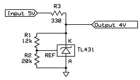

I have a page about the ADC converter on the Atmega328P. Somewhat down the page I describe voltage references. You can use the TL431 chip to provide assorted reference voltages, for example 4V:
4V voltage reference
By changing the resistors you can get other voltages (it looks like you want around 4.2V).
The output voltage is not influenced by the input voltage (5V in this case).
The linked page describes how you might choose resistor values.
