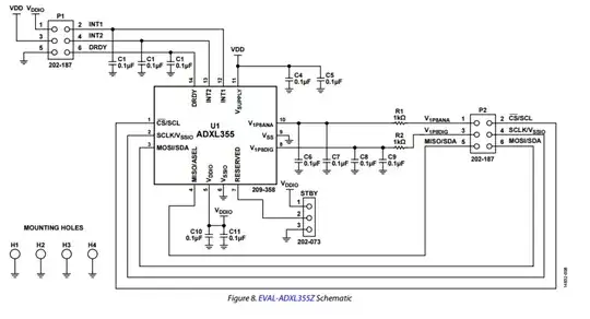

Per your post looks like you have not wired any grounds. Consider wiring Analog and Digital grounds.
ADXL355 Grounds
Here are excerpts from the datasheet
ADXL355 Ground Pins
  • Thank you. I forgot to mention that I wired the ground. But I did not the VSSIO. Someone also suggested it was because the sensor runs on 3.3 V and the Arduino on 5. – rur2641 Mar 13 '17 at 03:43
  • Regardless of 3.3V or 5V GND is 0V. DGND and AGND are internally isolated. So erratic behavior can be explained due to poor grounding. Good luck. BTW don't cross post questions. – Mahendra Gunawardena Mar 13 '17 at 08:51
    It could also be caused by insufficient or unregulated power supply. – SDsolar Mar 13 '17 at 09:17
  • @Mahendra Gunawardena 6 The VSSIO is tied to the VSS through the P1 6 pin header – rur2641 Mar 13 '17 at 15:18
