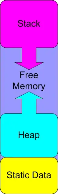

For this, you should first know how SRAM is organized inside AVR-based Arduino (it won't apply to e.g. the Arduino Galileo by Intel). The following diagram from Adafruit shows it clearly:
SRAM organization
Then you need to know the total size of your SRAM (depends on Atmel MCU, hence what kind of Arduino board you have).
On this diagram, it is easy to find out ths size of Static Data block as it is known at compile-time and won't change later on.
The Heap size can be more difficult to know as it can vary at runtime, depending on dynamic memory allocations (malloc or new) performed by your sketch or the libraries it uses. Using dynamic memory is quite rare on Arduino, but some standard functions do it (type String uses it, I think).
For the Stack size, it will also vary during runtime, based on the current depth of function calls (each function call takes 2 bytes on the Stack to store the address of the caller) and the number and size of local variables including passed arguments (that are also stored on the Stack) for all the functions called until now.
So let's suppose your recurse() function uses 12 bytes for its local variables and arguments, then each call to this function (the first one from an external caller and the recursive ones) will use 12+2 bytes.
