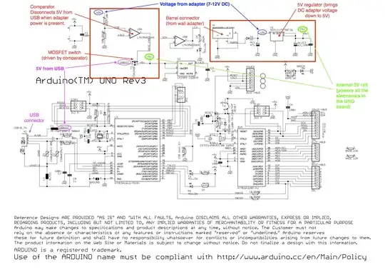

Actually, Arduino is powered at 5V (the 5V pin and the ATmega328p are connected to the +5V rail in the board). The point here is where do those 5V come from. Basically, from 2 possible sources:
  1. USB. The 5V line from USB is (or should be) already regulated, so it's feed directly (in fact it goes through a polyfuse) into the +5V rail of the board. The maximum current draw operating this way is 500 mA, limited by the polyfuse so you don't blow up your PC.
  2. Barrel connector (wall adapter). It accepts 7-12V and brings it down to 5V using a linear regulator whose output goes to the +5V rail of the board. The maximum current draw operating this way is 1,000 mA, limited by the regulator capability.
If both sources are present at the same time, preference is given to the wall adapter. The UNO board has circuitry that detects voltage from the adapter and disconnects (using a MOSFET switch) the USB 5V line from the +5V rail of the board.
This is done not only for convenience purposes (so you have more current available), but also for protection. Otherwise, you'd be connecting two power sources (+5V from the regulator and +5V from USB) which is a dangerous situation.
I have commented the UNO R3 schematics so you can see for yourself how it's done (both input sources, adapter voltage detection circuitry, etc.), see below.
Arduino UNO power supply
