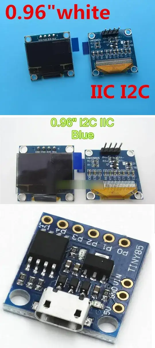

Devices used It's about these devices:
Devices
Quick scheme (how I connected those)
Got the wiring info from the TinyWire library
TinyWire

Question
What could be wrong, do I miss something inhere? Wires seems to be OK, do I use the correct pins (sometimes a little confusing on Attiny85, digital versus analog)? Tried also another OLED_I2C_ADDRESS, 0x3D instead of 0x3C but no luck at all. Tried both screen and both remain black.

    Ah, this is useful info, thanks! Got no 4,7K resistors but desoldered two from a spare board and guess what..... It works like a charm! Thank you very much for the execellent info. I'm happy, thumbs up! – Codebeat Feb 05 '17 at 04:39

I had a bit of a pain with this board, the drivers for Windows originaly not working or detecting the board correctly and then the board not seeing the OLED mine is the 128x32 version. I edited the code to reflect the screen size in the DigiSparkOLED.cpp
0xA8, 0x1F,      // Set multiplex ratio(1 to 64)
And change:
0xDA, 0x12,      // Set com pins hardware configuration
To:
0xDA, 0x02,      // Set com pins hardware configuration
Also on several sites it does say to use PINS SCL on P5 and SDA on P2 so if its not working maybe try that pinout. I used the one mentioned above and the I2C scanner is now seeing it on address 0x3C (I wouldn't try changing the address in my experience the pinout will be wrong)
Do your usual checks to see if the screen is drawing power on all lines with a multimeter, also run I2C Scanner program to see if it sees anything and if not then try the alternative pinout.
