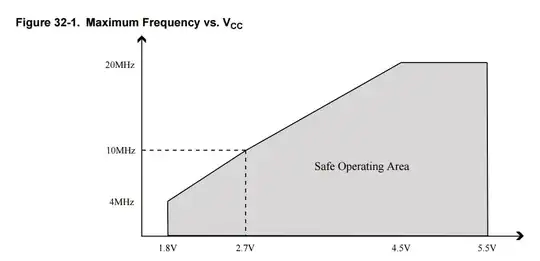

But that's not the whole story. The minimum voltage depends on the clock speed of the chip, as shown in this graph:

That gives you a usable range, clock frequency permitting, of 3.6V to 5.5V.

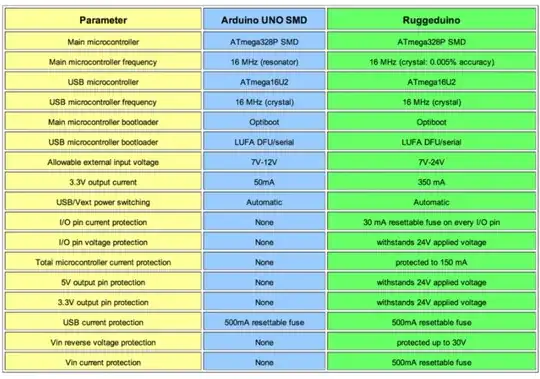

You don't say why you want this information, but there are others who are trying to do similar. (Starting with NOT destroying their Arduino)
For instance, at the end of the article
10 Ways to Destroy An Arduino
is a reference (broken link in the article) to
The Ruggeduino
which might be more suitable to your requirements.
Here is an excerpt of its specs:
