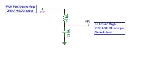

I wondered if this would give a more stable output.
PWN presented to RC.  Cap charges, sample is made by another analog input.  When PWN pin goes low, slow discharge of cap.  Maybe a large resistor is needed in parallel with the cap for slow discharge?
