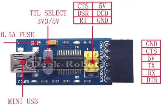

Recently, I came across a variant of the board shown below. However, what are the additional yellow header pins on this board for? They are labelled ISP.
USB-TTL FTDI Breakout board with ISP

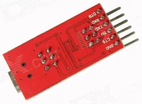

Here is a view of the rear:
USB-TTL FTDI Breakout board with ISP rear
So can they really be used as a standard ISP/ICSP?

However, according to the diagram below, which labels the 6 pins in question, I am not sure that there is a valid correlation of signal lines.
USB-TTL FTDI Breakout board with ISP with legend
That is to say, would CTS to MISO, RI to RST, DSR to SCK and DCD to MOSI work? Or is that why a special version of avrdude is required, as alluded to in FT232RL: USB to Serial 232 TTL Adapter –?and ISP? - post #6:

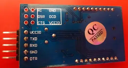

I made up a test as I had a similar board in my parts drawer:
FTDI board front
It had provision for a 6-pin header similar to yours. Turning the board over we can see that they were labelled exactly the same as yours:
FTDI board back
I soldered on a header (in yellow, to be consistent) giving me this:
FTDI board with header
I added a white dot to indicate pin 1 (visible on the edge) so I plug the cable in the right way around.
