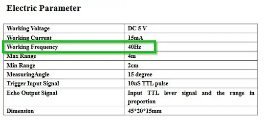

Your comments don't match your timing delay values and the datasheet specifies a 10 µs pulse. You're giving it 30 µs but you might get away with it.
I'd look at how often you're triggering the device.
Figure 1. Don't trigger the device more frequently than 40 times per second.
