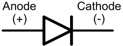

Cathode vs Anode
On a traditional LED, the long lead is the (+), Anode. The other lead being the (-) Cathode.
"Or, if someone’s trimmed the legs, try finding the flat edge on the LED’s outer casing. The pin nearest the flat edge will be the negative, cathode pin." - Sparkfun
Source: https://learn.sparkfun.com/tutorials/polarity/diode-and-led-polarity
