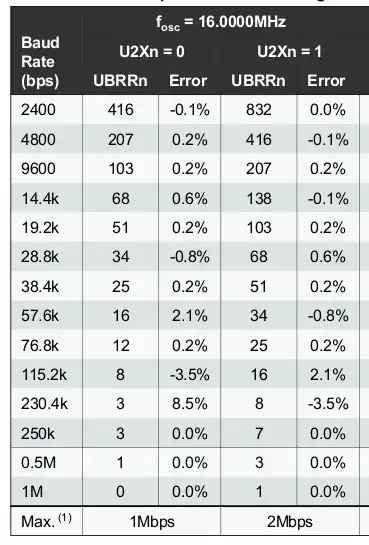

Baud rate errors
The baud rate on the Atmega is generated by dividing down the system clock, and then counting up to a pre-set number. This table from the datasheet shows the register values, and error percentages, for a 16 MHz clock (such as the one on the Arduino Uno).
Baud rate errors
The U2Xn bit affects the clock rate divisor (0 = divide by 16, 1 = divide by 8). The UBRRn register contains the number the processor counts up to.
So from the table above, we see that we get 9600 baud from a 16 MHz clock as follows:
16000000 / 16 / 104 = 9615
We divide by 104 and not 103 because the counter is zero-relative. Thus the error here is 15 / 9600 = 0.0016 which is close to what the table above says (0.02%).
You will notice that some baud rates have a higher error amount than others.
According to the datasheet the maximum error percentage for 8 data bits is in the range of 1.5% to 2.0% (see the datasheet for more details).
