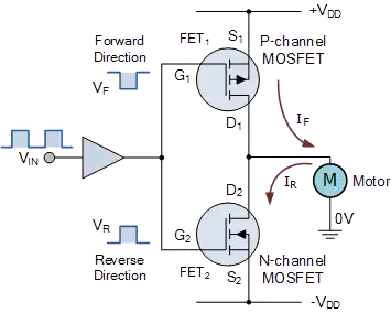

Bidirectional driver - if you want the driver to be able to drive a load high and low this circuit will work. from here
The input gate is in this case the internal processor driver. The two MOSFET gates connect directly to the processor pin. Vdd should usually be no higher than processor Vmax_drive_out. Slightly higher can be made to work with suitable design. Much higher voltage loads can be driven with this circuit (or similar) plus one extra transistor.
