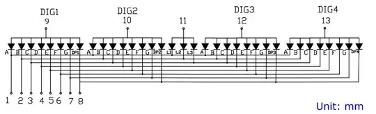

That tells you that it is a Common Anode LED display - which means that for each digit all the Anodes (positive pins) of the LEDs are wired together.
Further, all the cathode (negative) pins of the LEDs for the same segments across the digits are connected (that is the cathode for segment A on digit 1 is connected to the cathode for segment A on digit 2, digit 3 and digit 4, etc).
From that you can then infer that you need to provide current for each digit in turn through its common anode pin, and sink current from the segments you want to have lit for the digit that is currently having its current sourced.
The diagram also shows you which pin on the display is for what function - the common anodes are pins 9, 10, 12 and 13, with pin 11 the common anode for the extra dots.

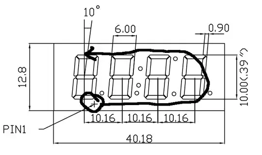

The datasheet also tells you which pin is pin 1 - in this case the one in the bottom left when you have the display facing you and the numbers the right way up. The pins count anti-clockwise from there, so 2 is to its right and 13 is above it.
By the sounds of it though you may not have the same display as in that datasheet. If your display lacks the extra dots then it may not have the LEDs on pin 11, and pin 12-13 may be moved down one, so you have 4 commons on 9, 10, 11 and 12 with no pin 13.
So the four digit select pins in your program are wired to pins 9, 10, 12 and 13, and the segment select pins connect to pins 1, 2, 3, 4, 5, 6, and 7. Don't forget the resistors on all the segment pins to limit the LED current or you will damage the Arduino.

As page 2 of the datasheet shows, there are 5 anode pins (4 digit and 1 aux) and 8 cathode pins (7 segments and 1 DP). Connect the digit lines to the digit anodes and the segment lines to resistors connected to the segment cathodes. The location of pin 1 is shown on the top right of page 2, and as always they go counter clockwise from there. Segments are lit by putting the anode high and the cathode low.

From the datasheet found by Ignacio Vazquez-Abrams:
7-segment display
Now one segment will light up if there is a positive (eg. 5 V) on the anode, and a negative (eg. ground) on the cathode. You need a resistor (eg. 330 ohm) to protect the LED and the output pin.
Hopefully it is clear from the original question which Arduino pins go to which LED pins.
Then the code which I presume you found will have to multiplex the display. That is, it will ground (send LOW) to the appropriate cathode pins for the number of segments it needs to light up (all of them, for example, for the number 8, except the decimal point). And then it will raise to 5 V (send HIGH) to DIG 1. That will make some segments on digit 1 light up. Then it repeats that for digits 2 to 4, fast enough that they will all appear to be on at once.
