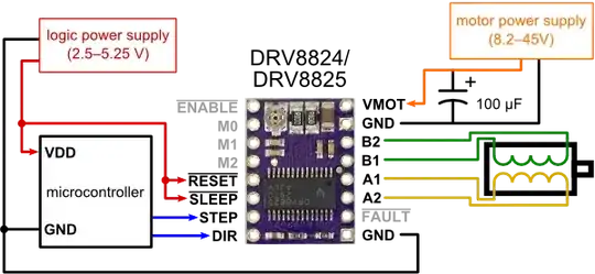

I'm using the Pololu DRV8825 Stepper Motor Driver to control a NEMA 17 Steppermotor with an Arduino Uno. According to the Pololu website, the circuit should be wired as follows:
I did, however, deviate from this exact sketch a little bit:
  1. The Arduino (microcontroller) is powered by a USB cable connected to the computer
  2. I connected the 5V pin on the arduino to the + rail on a breadboard. I then connected two wires on this rail to the RESET and SLEEP pins on the driver.
  3. I'm using a 9V battery to power the motor.
  4. I've connected the DIR and STEP pins to Arduino Uno pins 12 & 13, respectively.
Consequently, I coded and uploaded the following sketch:
