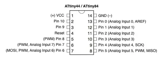

As far as the boards, if you feel comfortable with some extra work, I'd recommend an ATtiny. From what I can find, it seems like you can drive a LCD with a 44 or an 84 (similar, but the 84 is more powerful).
Source for image and how to program chip. I'm not going to go into the details for this method, as the link has the necessary files...
