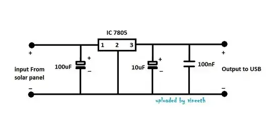

Since the external 5V supply is not regulated, it may cause some problems. It is possible that a small voltage difference will appear if and when the external voltage fluctuates from the 5V level. What you should do is short-circuit the 5V of the USB to pin 27.
And in general, add a 5V regulator circuit to feed the Arduino nano, like this one: http://www.techulator.com/attachments/Resources/10562-75631-V-Voltage-Regulator.jpg
Vassilis
  • 36
  • I don't think, shorting VUSB to +5V is a good idea. By this, you bypass D1. Hence, if +5V is slightly higher than VUSB, you may overload the regulators of your PC's USB port. The other thing is: @Masure did not write, the voltage supplied was unregulated. Hence, applying a linear regulator to an already regulated 5V will let the voltage drop below 4V, which is pretty useless, because all power will be drawn from USB then via D1. – Ariser May 16 '15 at 10:00
  • @Masure wrote "...which is powered through unregulated 5V (pin 27)". That's why I suggested that – Vassilis May 16 '15 at 10:16
  • Yes, but Masure probably wanted to express, that by supplying the voltage via this pin, the builtin 7805 is bypassed. Otherwise Masure just had to connect the unregulated voltage to Vin. No need to apply another regulator. – Ariser May 16 '15 at 10:20
