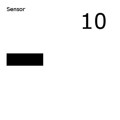

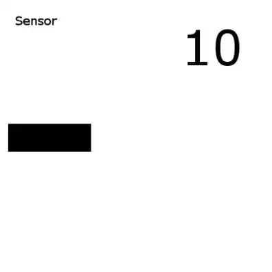

One issue with this approach is, if the line of transformation of the object is not perpendicular to the line of the pings, the value will go:
10 → 11 → 12 → 13 → 14 → 15 → 16 → 17 → 18 → 19 → 20 → [Out of range]
I've added some pretty animations to show you what I mean:
Perpendicular:
Collinear:
