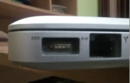

I have a MBP 15" 2011 model and has is the burned magsafe port (leftmost pin melted) which i noticed today.
The connector gets too hot sometimes ( but remains ok when I charge in sleep mode). Sometimes the charging will stop and LED will become green and then I reconnect it to get it in charging mode.

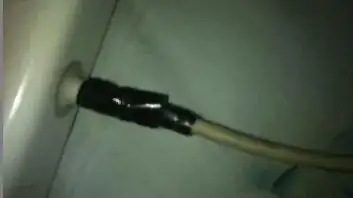

The Frayed cable: very light cut at connector side conector side
and heavily frayed at brick as shown. brick

    Before you go spending any money, I would advise you to first figure out what caused the MagSafe port to burn. You wouldn't want to go spending hundreds for your new port and charger and then have the same thing happen again, would you? – Aiden Aug 01 '13 at 03:19

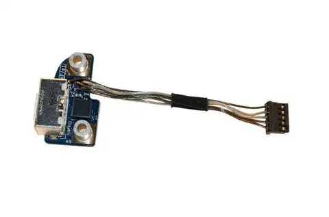

The MagSafe board is a very easy repair for someone who has patience and a small amount of training fixing any computer at all. The MacBook Pro aren't as fidgety to repair as the iMac and MacBook Air (where I would say you should be a skilled technician with official training materials available to work on them reliably).
MagSafe board
You're looking to replace this with a handful of screws turned.
Go to iFixit.com and look up the repair guide and parts list for the DC in board and you will know if you have the skills to find the right part, the right tools and the right manual to undertake this work. Otherwise, pay a local technician to do the job/source the parts/give you what they feel is a good guarantee. As for the adapter, buy a new or used one on the aftermarket or from Apple. When the cord is crushed and frayed, it is designed to fail in a way that won't cause a fire hazard. I wouldn't mess with that end of things or with repairing the transformer itself.

Question is why it got that way?
Can you continue ? well at your own risk, since that could result in a small fire !
You need to find the root cause and fix it.
You could order new cable from Amazon have it 1-2 days for about $50, but that does not solve the root cause.
Take look at what Power adapter you have now, is it 60W or 85 Watt.
Do some troubleshooting from Apple.
