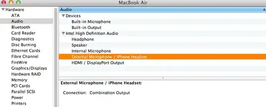

Looking under the hood of Apple "About this Mac" you get the answer (it says it does support it).

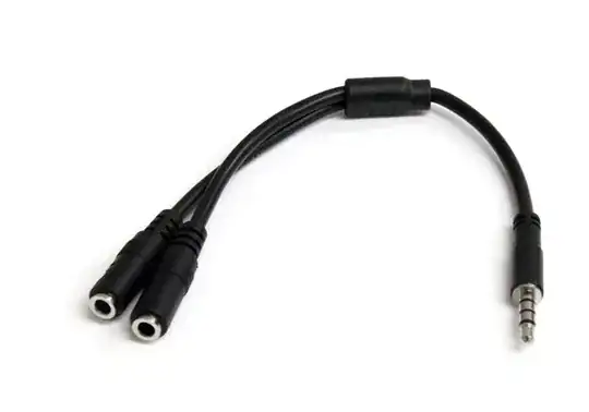

Get the 3.5mm 4 Position to 2x 3 Position 3.5mm Headset Splitter Adapter - M/F
... this headset splitter adapter breaks the audio port out into two distinct ports - one that can be used for a microphone input connection, and the other for connecting external (output) speakers.
I found stores in Europe (for about €10), but sure you can find it where you are.

Alternatively try that 3.5mm 4 Position to 2x 3 Position 3.5mm Headset Splitter Adapter - M/F that Buscar mentioned above.
Yes, it seems the option is missing from your settings: this is what that preference panel looks like on my machine (13-inch, Mid 2009) (with nothing plugged into the audio port):
Unfortunately it looks like audio input isn't implemented on your model :(

I have ordered a splitter (analog, known as "auxiliary" and "audio" splitter), that has one 3.5mm male TSSR plug on one end, and 2 female 3.5 female ports (unknown if TSR or TSSR) on the other end. Supposedly, one female port will provide microphone input, and the other female port will provide headphone/speaker output.
From everything I've read and researched, I'm pretty sure this will be what's needed to get microphone in and audio out from the one "headphone" labeled 3.5mm port on the MBP.
I'll try to remember to come back here to update once we get that splitter (http://www.dukabel.com/product_D1M2FFL30.php), to let you know if it works :-)
