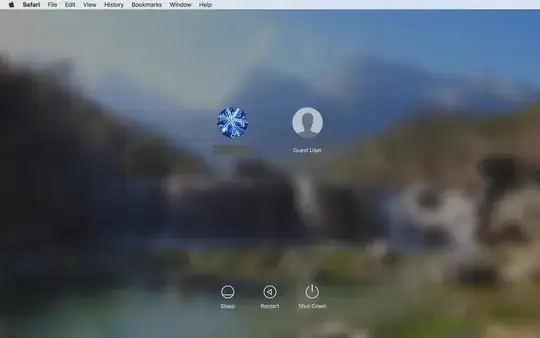

This probably might be late. But I hope it solves the problem for future generations. With the addition of the touchhbar this issue is even more serious.
Scenario: When you are connected to a second display, sometimes we tend to lower the brightness of the MacBook to zero to focus on the large second display. This stops you from viewing any warnings or notifications on the battery or power status. When your system shuts down in this setting, your are probably facing the black screen issue.
Now when this happens, as a user, we would have tried to press and hold the power button and at times, it could trigger a restart taking you to the Recovery mode with three options
  1. Forgot password
  2. Password doesnt work
  3. Keyboaord doesnt work.
Solution: In the left top click the Apple menu and shut down the system. Now that your system is shut down. Its time to power it up. On the assumption that We still don't see anything on the monitor, leave the system for about a couple of minutes. Now think of how you normally login to the system and how many login users you normally see and which one is yours. For example: Check the below image as example [Image downloaded from Apple forums]
We are going to follow the below steps assuming your display is still black and you are in the login process rather than the recovery process.
Step 1 : Click the right arrow button. This focuses you to the first user in the system
Step 2: Based on the user you normally login, click the right arrow and focus on your login.
Step 3 : Click enter.
Step 4 : Enter your password
Step 5: Click enter again
Leave the machine for a couple of minutes... Hurray, you might be able to see your screen!
It's important you know which user you are and your password. If it doesn't work, try switching it OFF and ON, and follow the steps again with a different user (Step 2).
