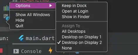

For me with just two screens. The above mentioned solutions didn't work as the new apps would open in the laptop itself. What worked is moving dock to right. Dock to right
Also I had to do this https://discussions.apple.com/thread/251274566
  1. Go to mission control
  2. Add a new desktop
  3. Right click on the app in dock
  4. Delect options and select the display
select display from doc
