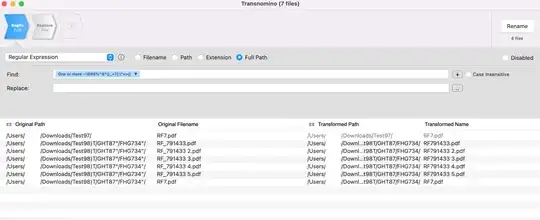

I'm currently using Transnomino (hard to find decent functional ones) and this is how I used the app to rename filenames and filepaths :
  1. Open the app
  2. Select Full Path (in this example) & set the replace criteria to Regular Expression Transnomino main window
  3. Click on the + button on the right then, in the Find: entry, double-click on One or more entry Transnomino Find field
  4. Set the Count to 1 (for 1 occurrence). Then add specific characters you need to remove from file name and filepath in Custom Characters, in this example : ~!@#$%^&*()_+?[:"<>|] Transnomino enter characters
  5. Return to main app window and fill in the Replace: field with what you would like to replace the specific characters mentioned above with (if you need to replace them with nothing, just leave it blank) Transnomino replace field
  6. Open your Finder folder and drag the folders/files you want to apply this to Transnomino files drag
  7. Note the files that are grayed and the others: when it's gray, the app doesn't need to change anything (= none of the specific characters are present in filename or filepath). All the others CAN be renamed. Transnomino rename summary
  8. If you're satisfied with it, just click Rename. Et voilà Transnomino renaming complete
