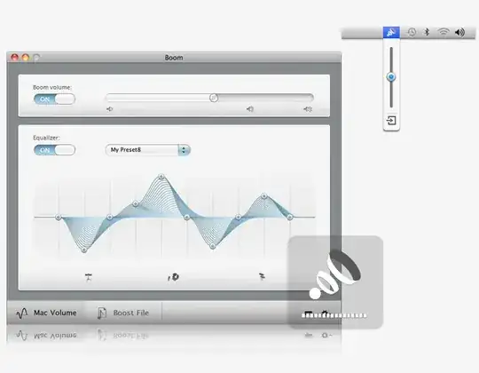

Try the Boom system-wide volume booster tool. While it's not free, it is cheap: $6.99. See reviews here, here, and here. Below is the description from the product page, and a screenshot:
Boom is a simple volume booster and system-wide equalizer that lets you boost the volume of your Mac and your music files.
Using Boom is simple. You know the ways to change the volume of your Mac. Boom provides the same easy access to boost sound.
From the videos on YouTube, Hulu, your favorite music playing on iTunes, to voice applications like Skype, iChat and your favorite Games, Boom can boost them all. [...]
(emphasis above is mine)
Boom screenshot
I use Boom on my own MacBook Air and it does a reasonable job of increasing the internal speaker volume beyond what I was getting with the built-in volume controls at maximum. The graphic equalizer is an added bonus, letting me tweak the sound I get from these tiny speakers so it sounds a bit better for music.
