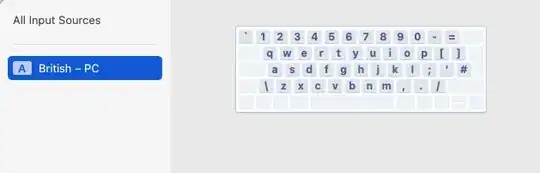

In Karabiner-Elements, under "Virtual Keyboards", try setting "Country code: 0" to ISO
Karabiner-element screenshot
Once that's done, System Settings > Keyboards > Input Sources should see the British - PC input as ISO (the enter key is an upside-down L, and the ` and \ are in the right place)
ISO layout in system settings input source
