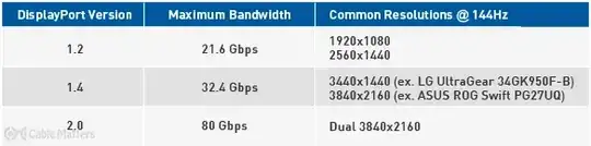

Check the maximum resolution that is supported by the monitor cable. I had a similar problem as I was using an HDMI to miniDP cable which maxed out at 1080p.
Changing to a Display Port cable immediately resolved this issue.
In my understanding, you need a Display Port cable (version 1.2 or above) that supports higher resolutions (2k or 4k). Check out the image below for supported resolutions for different display port standards. Source link.
