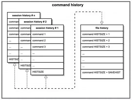

Your bash history consists of two "histories", not one. One of these histories is stored in a file - its size/depth is governed by the parameter HISTFILESIZE. The other history is cached in memory - its size is governed by the parameter HISTSIZE.
You can check the sizes/depth of your histories:
$ echo $HISTFILESIZE
$ echo $HISTSIZE
The reason for two histories is that one is associated with each shell session (HISTSIZE), while the other history is a file ~/.bash_history that is "permanent", and eventually receives the session histories when they overrun their max depth, or when the session is terminated. That's a bit complicated to explain, and the picture below may help make the relationship between these two histories clear.
