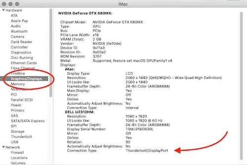

Yes. System Report. Click on the Apple Logo (top left of Menu Bar) *About this Mac → System Report → Graphics/Displays

If I understand correctly, if you connect an external monitor to a Mac there is more than one way the signals can be sent to the monitor.
Not exactly. Generally speaking there's only one way signals are sent to your Mac and that's from a DisplayPort signal. There are Macs with HDMI ports (Mac mini for, example) but since we're referring to the USB-C port - there's only one connection - DisplayPort.
Your end device (monitor) may be HDMI, however, and depending on how that signal was converted, it my be unidirectional. In other words, it won't communicate back that it's using HDMI.
Yes, you can use a USB-C to HDMI or DVI or even VGA adapter. The DisplayPort signal can be converted to these formats with passive or active adapters (I suggest active).
