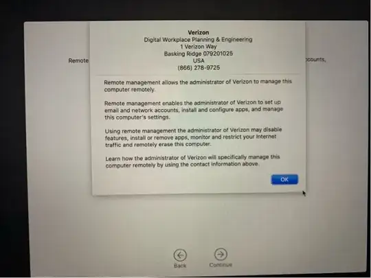

Very large organizations like Verizon likely have their devices enrolled from the factory, it could be new but it's likely stolen, innocently mixed up as a retail product for sale or liquidated to a 3rd party as "new old stock" (unlikely IMO). However, generally speaking, when you see this screen, it's usually not “brand new in the box” as you describe. The fact that it had MDM installed/enabled (manual process) means at a minimum, it was configured for use. The moment that happens, it’s no longer "new" but "used" (pre-owned) or at the very least it's considered "Open Box."
The problem here is that you could have something that is legitimately sold from Verizon to the third party via liquidation and the MDM was innocently overlooked to it being a stolen device in which case, if you are in possession of it, you could have it confiscated by authorities without compensation back to you.
In this particular case, Verizon being a large company with a large bureaucracy, it will be a Herculean effort to validate its legitimacy and to get MDM removed. I would return this to the person you purchased this from for a full refund as it’s not as described - brand new. Let the vendor deal with removing the MDM - this is the "value add" he's supposed to provide.
