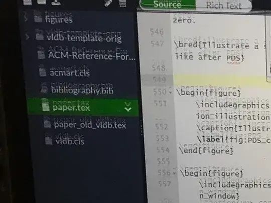

On my MacBook Pro 2017 15" (A1707), however, after a couple of hours of use on (arguably) high temperature, the internal monitor (not the external one) starts to flicker badly, like this:
The screen keeps flickering until I shut down the laptop, (or I close the lid and work with external mouse and keyboard, and after 1 an hour, the screen is OK when I open the lid.)

You must take it in as it’s a physical issue
Yes, it is inconvenient and time consuming, but there is no software hack that’s going to fix this. So, to get the tech to see the problem, video it. Let them know that it can take hours to manifest, but if you have video of the problem, it becomes very difficult for them to dispute your claim. Additionally, you can try to “speed up” the failure by stressing the GPU with some benchmarking software.
As for verifying it after the fix, the same stress test can be used to quickly determine if the fix was successful.
It’s likely not the cable
Yes, flex gate is an issue, but I’ve never seen cable/temperature related issues. I would be more inclined to believe it’s substandard components like a capacitor, resistor, or transistor that’s at fault here. A lot of the 2007 through 2010 Macs with GPU issues were due to substandard capacitors. Put “larger” ones in and the issues went away. As for the cable, the issue usually manifests when opening the lid past a certain point, regardless of temperature. The other cable issue is that Apple decided to put the backlight pin (48V) adjacent to a data pin (3V) that went directly to the CPU/GPU. If this was your issue, you’d know it as your Mac would be dead.

  • Thanks. What do you mean by "past a certain point"? After some hours of work? Or after a certain date? The screen keeps flickering until I shut down the laptop, (or I close the lid and work with external mouse and keyboard, and after 1 an hour, the screen is OK when I open the lid.). Does it look like a GPU issue? How can I figure myself if it is related to the heatsink, fans, etc? – Ali Jun 13 '20 at 11:21
  • After a certain point means angle in relation to the body of the Mac. That angle differs from Mac to Mac. It looks like a hardware issue. If you want to see if it’s a GPU issue, run GPU benchmark software and see what “breaks.” Also, when you’re seeing the problem, take a screenshot. If the problem’s not in the image, it’s your GPU. But, in the end, you need to take it in for service by a pro. – Allan Jun 13 '20 at 11:25
