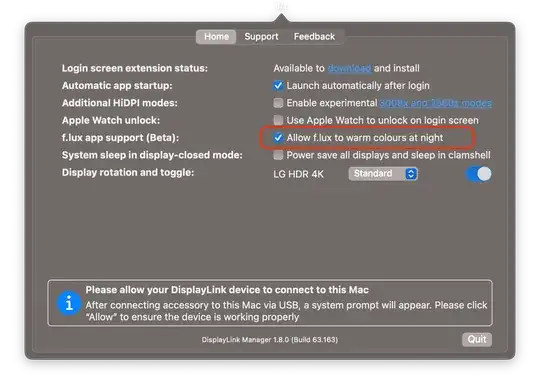

I have an ALOGIC Docking station which uses the DisplayLink Manager application. I was also facing the same issue then found an option to enable it from the DisplayLink Manager settings (Check the image below).
I know you might have tried your settings. Can you try downloading DisplayLink Manager it provides settings for f.lux out of the box. DisplayLink Manager settings
