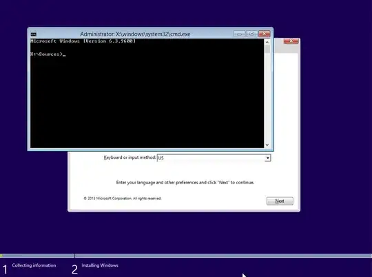

Press the shift+F10 key combination to open a Command Prompt windows, as shown below.
Enter the commands shown in the example below.

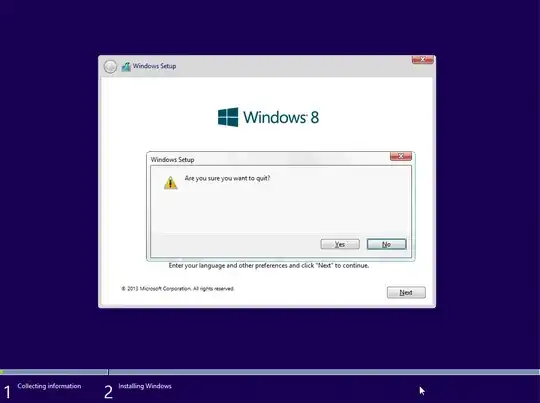

X:\Sources>exit
After the Command Prompt window closes, click on the red X. When the popup shown below appears, click on the Yes button.
