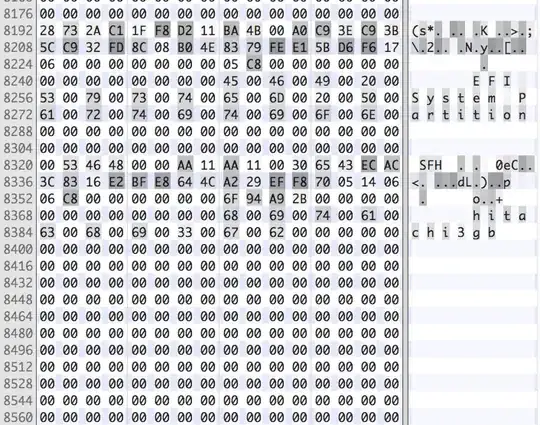

The drive was originally formatted with a single partition using Mac OS X Snow Leopard. I found the HFS+ partition type GUID while scanning through the data in the hex editor, Hex Fiend:
53746F72-6167-11AA-AA11-00306543ECAC (Apple Core Storage Container HFS+ FileVault volume container). This was followed by the 1st EFI part entry is at offset 4096:
The 1st EFI system partition is at offset 8192:
I attempted to extract the GPT/EFI and HFS partition information from the above image:
06 00 00 00 00 00 00 00 = 6 (start of EFI).
05 C8 00 00 00 00 00 00 = 51205 (end of EFI).
06 C8 00 00 00 00 00 00 = 51206 (start of HFS).
6F 94 A9 2B 00 00 00 00 = 732533871 (end of HFS).
The secondary EFI system partition at offset 3000592957440 appeared to contain the same start and end values, and the secondary EFI part entry was at offset 3000592973824.

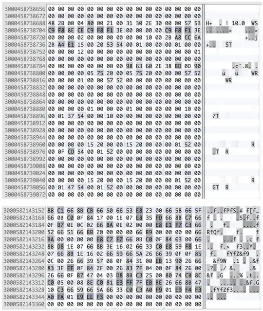

I think I located the 3rd partition at offset 3000458738688 bytes (it was the 1st data string following the end of the HFS main volume). It appears to end either at offset 3000582143352 or 3000582143360 (any input on this is appreciated):
Unlike EFI/GPT and HFS, there didn't appear to be start or end addresses in any headers that I could extract for this 3rd boot partition. Note that I added larger partition images to show this. So I'll try using the above estimated byte offsets (converting to sectors/blocks) as input for the 3rd gpt add step.
Thanks again for any feedback!
