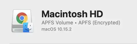

After upgrading to Catalina 10.15.2 the Macintosh HD icon on my Desktop and other places is showing what looks like a Chrome disk image icon instead. I've tried restarting and running first aid on the volume with no changes. Any ideas how to restore the normal icon?

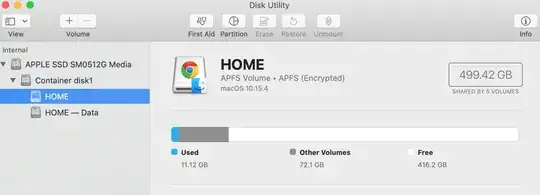

Experienced the same issue since the upgrade from Mojave 10.14 to Catalina (10.15.1), felt unreal and confused. Spent 10-15 mins searching and troubleshooting trying to fix but no luck (including Get Info - Upper Left corner - select the Icon - ⌘ + delete - it didn't work).
Mysterious and no one can explain how and why it happened (if you can, please_).
Disk Utility.app show the same Chrome Disk Image icon, didn't find a way to force a refresh or delete it.
I was hoping that the issue would be fixed by macOS patches but obviously NO up until 10.15.4, that's why I ended up here lol.
