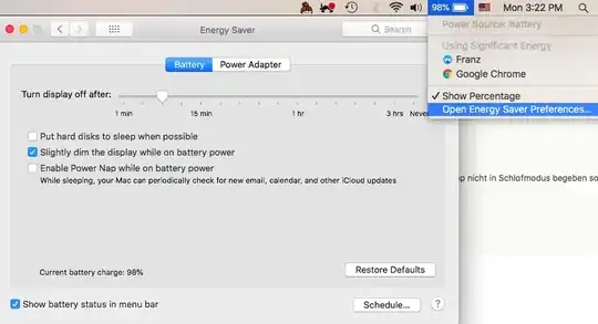

As long as it is connected to power there is no problem, but I would like to solve the issue. So far, I have reset the system management controller (SMC) (https://support.apple.com/en-us/HT201295) which unfortunately did not change anything. I also unchecked the "Put hard disks to sleep when possible for both the Battery and Power Adapter settings of the 'Energy Saver' (see below), which unfortunately also did resolve the problem.

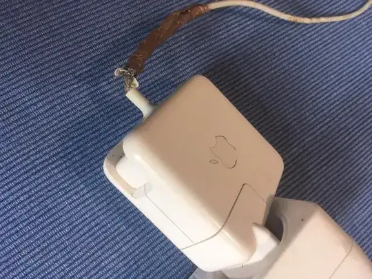

I'm also worried that my power cable should be replaced (see below, really being honest that I know very little about electricity and battery tech):
